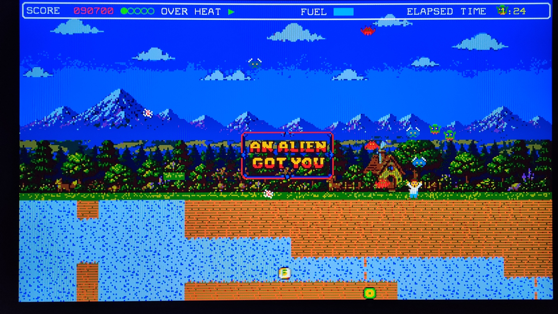

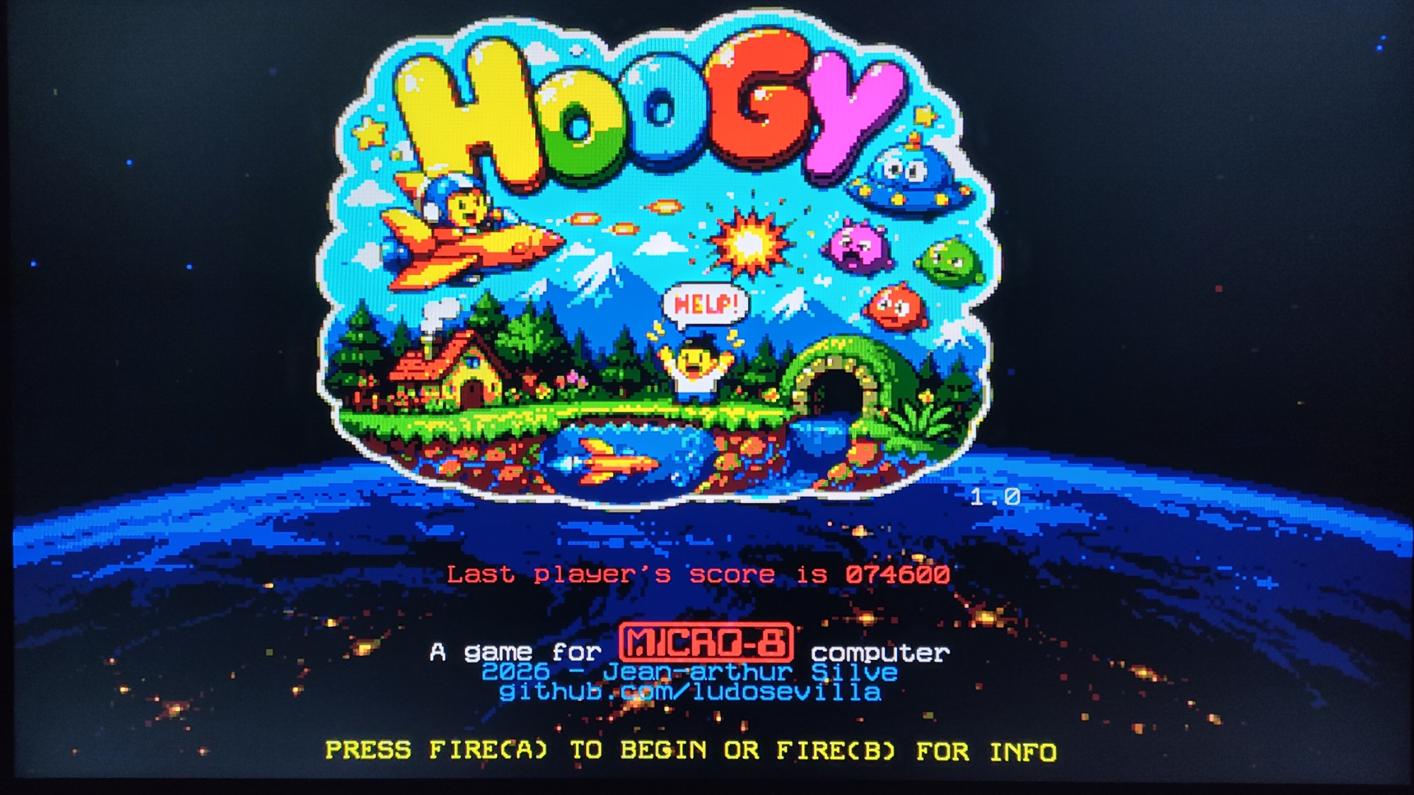

Still exploring the Micro-8, I'd like to introduce my new game: HOOGY (need last OS ver 0.7.9 !)!
The concept is simple: blast the aliens, help Mr Hoogy by sending him hearts, and, from time to time, make your way through a tunnel!
At first, the aliens are fairly harmless... but things quickly get out of hand!
Action is everywhere, enemies are firing from all directions, your laser overheats, and there's plenty of noise!
I'll let you discover the rest for yourselves!
In the end, our little Micro-8 proves once again that it's more than capable!
Source available also on GitHub : github.com/ludosevilla/Hoogy
Technical Notes
One of my goals was to make use of raster interrupts and display lists to implement parallax scrolling.
There are still a few occasional glitches that I haven't been able to track down yet. It's almost as if some raster interrupts are occasionally being skipped (but probably not).
As for the sound effects... well, they are what they are! I'm definitely not a musician, but in the end they give the game a nice 1980s arcade vibe, which I quite like. 😄
